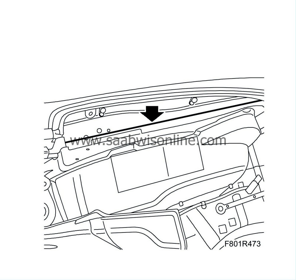

RoccoH
Re: Water in de kofferbak!
Bron: https://saabwisonline.com/b2/9-3/2005/8 ... cedure-82/
Water in the luggage compartment
Fault symptoms
Cause: As a result of inadequate sealing there could be leakage in through the area adjacent to the hinge plate following heavy rain or car washing.
Cars affected: 9-3 CV
Materials
90 273 919 Seal
12 794 960 Tape
Procedure
The procedure must be carried out on both sides.
1. Remove the grey tape.
2. Apply the seal 90 273 919 as illustrated.
3. Fit new tape.
Fault symptoms
Materials
90 273 919 Seal
12 794 960 Tape
Procedure
3. Fit new tape.
